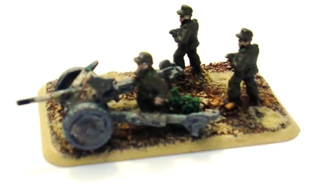

I go for grey spray with a vallejo black shade wash, paint in block colours then give them a wash with W&N nut brown ink

Thinking about it I may have washed these with a very watered down AP strong tone ink rather than the W&N nut brown
