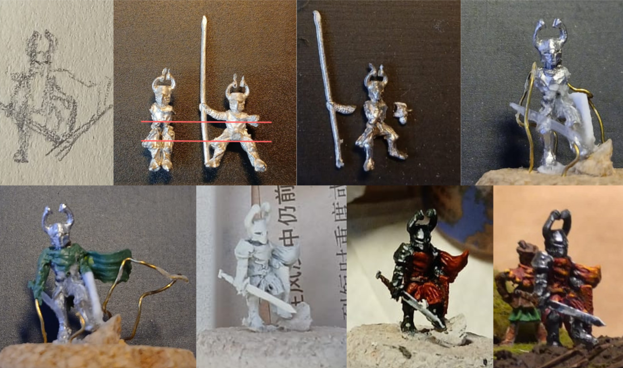

In this image you can see the process broken down into stages:
1. Original miniature and cut-down version.
Here I mark the cutting lines, and with double lines the cuts made with clippers. The aim is to achieve a more dynamic pose, breaking away from the stiffness of the original figure.
2. Pose adjustments.
You can see how I eventually cut the arm to allow a better rotation and slightly hunch the figure, so it sits closer to the horse when riding. I also file the contact area with the saddle to further adjust the pose and enhance the sense of movement.
3. Overall layout with a first layer of putty.
At this stage the full scheme is in place with a first layer of putty applied. I'm still undecided between axes, maces, or flails for the weapons.

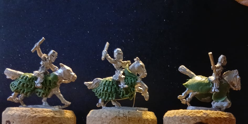

Hi everyone,
No need to worry about me, I finished and painted the miniatures last Thursday and Saturday for the Pendraken Painting Competition 2026. I just did not have time to post updates because everything coincided with Chinese New Year and all the gatherings and celebrations that come with it.
The three riders were cut at the joint points, waist and arms in every case, to achieve those dynamic poses you all seem to enjoy so much. After that, I filed down the horse barding to reduce the bulk and make room for three layered additions of texture, hanging cloth, flaps and fringes.
They were sculpted at the same time by drilling two parallel lines of small holes and then shaping the fringes between them. Some edges were stretched and slightly lifted to add more movement and dynamism. I will trim and refine them later once everything has fully cured, using clippers.
That said, those original poles did not look very threatening, so that definitely needed fixing.

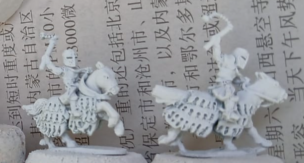

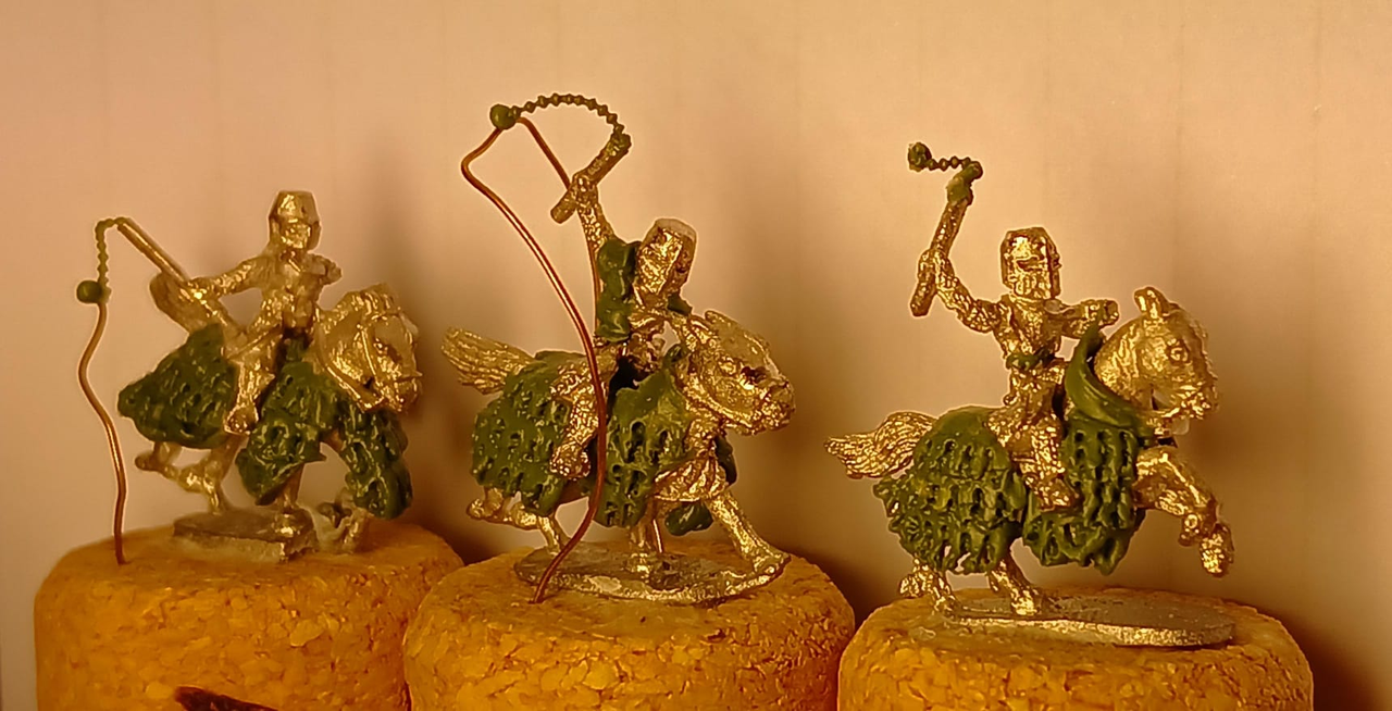

MonAtArms
Now came the key example.
After experimenting with axes and maces, I realised they simply did not provide the level of dynamism I was aiming for. It would have been counterproductive to push for dynamic poses and then not reinforce that energy through the weapon choice.
Initially, I considered making spears with small banners wrapping around the shaft. However, that would have required paper work techniques I have never tried before, and I still need to learn from the experts on this forum before attempting that.
So I chose something even more challenging: flails.
At first, the idea was simple, just use a copper wire. But once I started, I got carried away and decided to sculpt them from scratch.
They looked very nice with detailed chain links, but the problem was that I had to sculpt them flat first and then build up the second volume layer, which reduced the sense of movement. Another issue was consistency. I could sculpt them with extreme detail, but they would lose structural strength.
Then a rather unusual idea occurred to me. We see the miniature in three dimensions, not four. The fourth dimension would be time. If each link was made as a small sphere, the visual effect would suggest chain links in motion.
So I used my roll maker tool, I am including an example below.
One very important detail. The putty must be freshly taken from the fridge, or even better, mixed and then left in the fridge for a few minutes. Try to avoid handling it too much, or clean your hands with alcohol and glycerine beforehand. That way, the smallest grooves in the roll maker resist being flattened and the shape holds much better.
After that, I reinforced everything with two tiny drops of superglue. A copper wire core was used to maintain the dynamic curve and position.
Notice how each sphere at the end determines the overall movement, from left to right. On the left, the flail is bouncing with the gallop, showing the weight of the head. In the centre, it is mid-swing, building momentum. On the right, the rider is drawing the head back after a strike.
Honestly, everything I learned just from solving this small technical challenge made the whole base worthwhile.

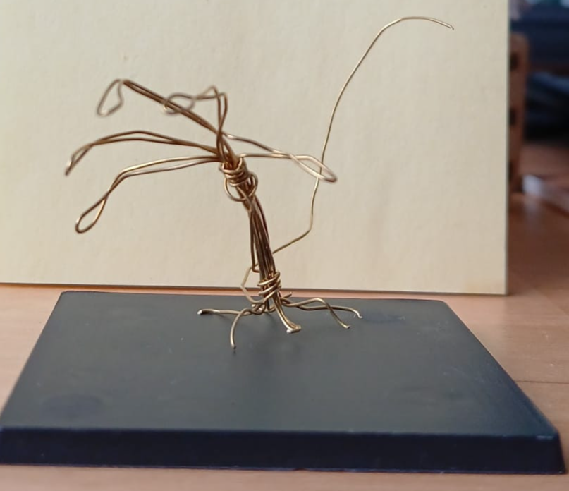

I had never made one before, so I relied on imagination. I twisted similar pieces of copper wire together in the centre to form the trunk, positioned the roots at the base and opened the branches at the top.

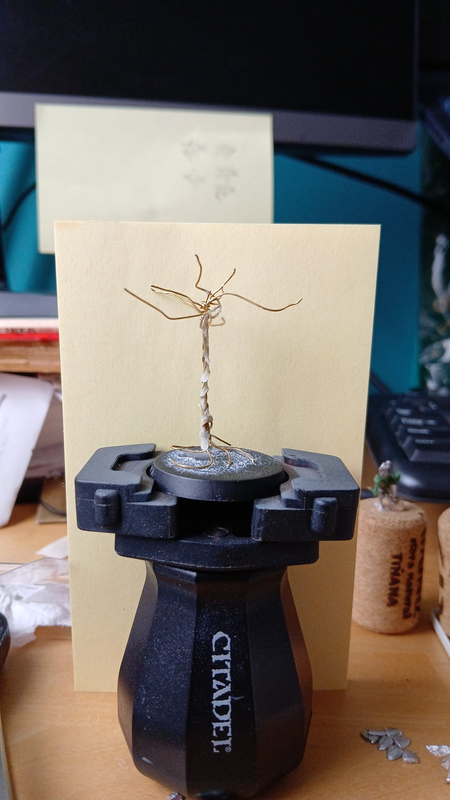

The next step was another experiment. I had some old pots of Magic Sculpt that had technically expired and had never been used. One of them had let air in and the colour looked terrible, so I decided that would be perfect for the tree.
There was no sketch and no fixed plan. I simply let the tree grow as I sculpted. First a uniform layer, then I used a sculpting blade to carve bark texture lines. The roots were treated in a similar way, knowing that some of it would later be covered by the base decoration.
After that, I positioned the knight in parts and set the arm positions with wire armatures. I cut the horse's legs and head and reposed them, then applied green stuff.
I added saddle bags for books on the horse's rump and gave the barding a cloth texture.
The original book, complete with bookmark and covers, was first sculpted over soft plastic, but later I replaced it with a piece cut from a toilet roll cardboard tube. It may not be obvious in the photos, but it actually has pages.
With the leftover green stuff, I added additional branches to the tree.

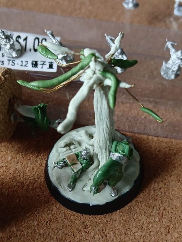

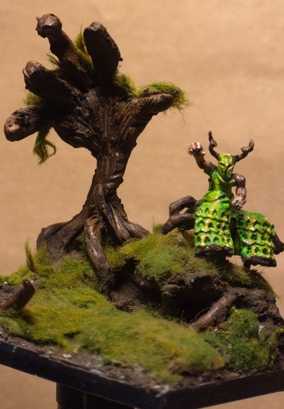

MonAtArms
As we keep learning through the process, I really enjoyed making the tree and roots in the previous piece. So the next question was: in what context could I push that idea further?
Since I play Dragon Rampant and wanted something clearly fantasy, I started with what I had. I have a knight, I have a horse, so that gives you a mounted knight. Then the idea of a druid centaur appeared.
At first I considered making a more traditional druid, but since Rampant is so flexible, I thought I could go for something more primal. After a few sketches in my head, it started to look too much like a standard beastman. Then I remembered a figure I had sculpted before, the Green Knight from Warhammer Fantasy Battle, and decided to add another layer to that fusion.
But first, the base.

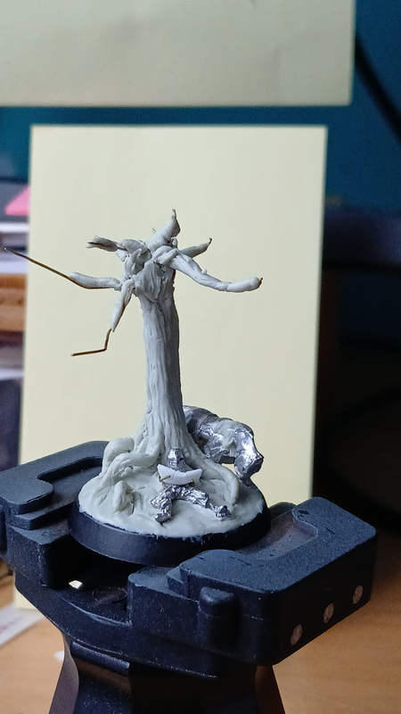

I did not want a spell-casting druid standing still. This druid would represent a force of nature emerging from the shifting shadows and beams of light filtering through a dense forest. He would be a combat unit, bringing trees and roots to life and striking with them.
So the starting point had to be the tree-hand and roots that mimic the movement of his arm. As in the previous piece, it grew organically as I sculpted, giving the impression of a tree stump that relied more on its roots, which creep forward almost independently. I carved open bark textures and shaped the roots so they appeared to function like legs, spreading across the base and even lifting the ground as they advanced.

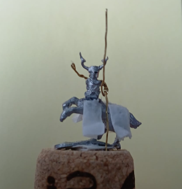

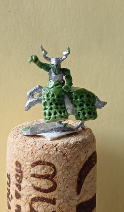

Then came the centaur.
I made the barding from paper hardened with superglue. The hand was built with wire, and for the horns I split the original rider's head and used the leftover flash as an extension of the antlers.
After the first layer of putty, I decided to leave the arms unarmoured rather than adding plate. That reinforced the idea of raw natural strength. Even without magic, this would already be a dangerous opponent.
Initially I planned to give him a staff from which roots would emerge, but at this scale the effect would have been lost. So I restructured the pose of the left arm and closed the hand into a fist instead.
The barding received the same fringe treatment as the flail riders, keeping visual coherence across the force.
In the end, this miniature almost created itself.
