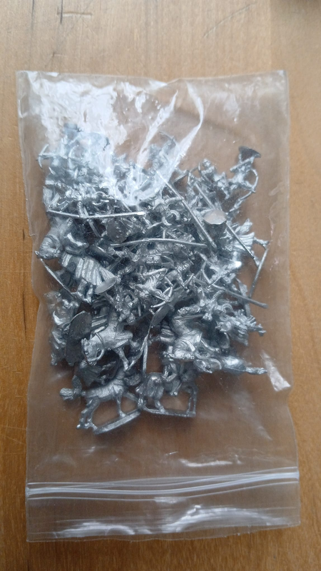

To be honest, this has caught me a bit off guard, as most of my workshop is currently on the other side of the world. Luckily, I brought my basic tool kit with me, and I also had a wonderful leftover Pendraken bag that turned out to be perfect for this.

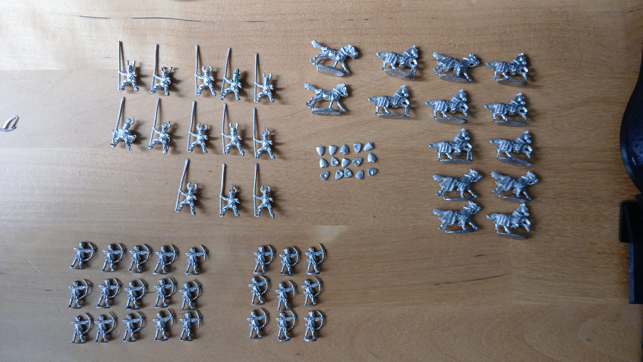

In terms of figures, I'm starting with:
  • 13 cavalry
  • 24 archers
  • 2 unarmoured horses
  • 12 barded horses
  • 15 shields
I'll be posting regular updates as the work progresses until end Febraury. Suggestions and ideas are more than welcome. Early-stage feedback is especially welcome; once I move into final assembly, changes will be limited.

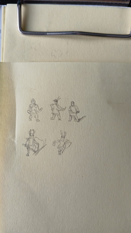

Meanwhile, I have the first full-size sketches to get things warmed up.

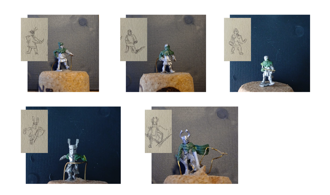

First examples of the work in progress. Three archers and two mounted knights converted into dismounted knights.
If there is interest, I can share more images of the process.
I made a new sword by cutting and reshaping plastic, and did the same with the shield, as I needed it to be larger. All the areas that will later be covered with putty have been roughened, and I have also built the basic armatures for the new arms using wire.
All suggestions and feedback are very welcome. Many thanks in advance!
If there are no major updates this week, I will upload photos of the four-base composition to get things started.

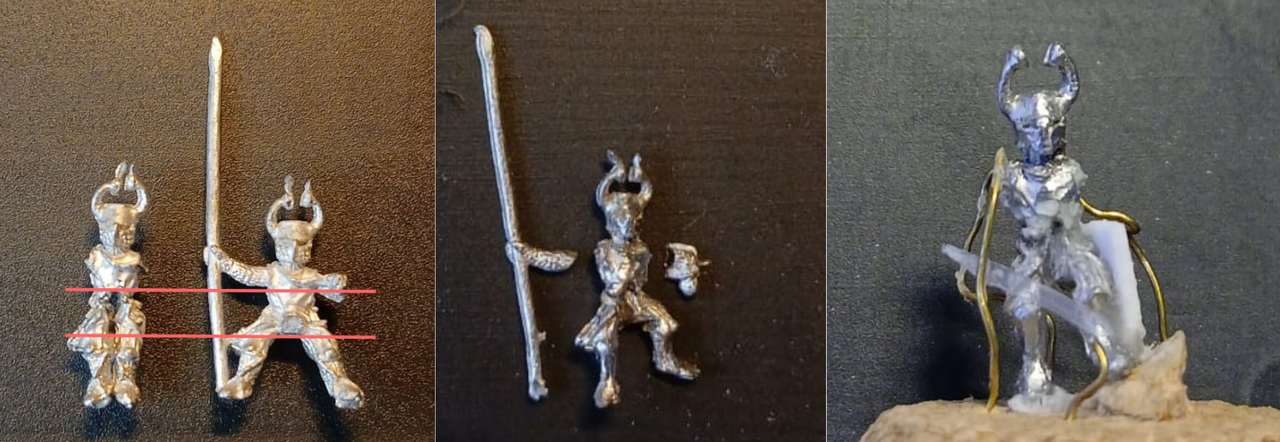

Glad you like it, comrades! 😊 Luckily I took a few more photos along the way.
The image on the left shows a comparison of the same miniature, but with the belly opened almost up to the chest so I could properly adjust the legs. The next photo shows the limbs assembled separately to fine-tune the pose, and the third one is the filing stage before applying the putty, to avoid it ending up too thick.
At these scales this step is absolutely critical—otherwise the modelling putty quickly becomes oversized.
And you're completely right: washing-up liquid is essential, and an ultrasonic cleaner probably doesn't hurt either!
Very impressive- I hadn't spotted it was the cavalry figure you had used to make the foot knights!
