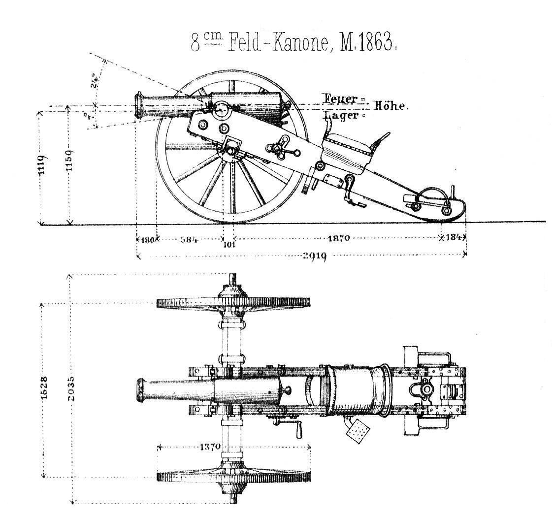

Rather puzzled! I had thought I knew the war of 1866 pretty well, but I cannot recall an Austrian 10pdr, only 4 and 8pdrs. Have I missed something? HELP!!!!
kustenjaeger
Are we sure someone isn't using a British pound measurement where 8 Austrian pounds @ 0.56kg (so about 10lb UK)?
Edward
Gwydion
Perhaps a mid read for the 10cm (8lb) piece?
sultanbev
I'm baffled too, not something I've come across. There were some 12cm M1860 La Hitte 12pdr rifled muzzle loading cannons that had been relegated to fortress artillery in 1863 (still in use in 1918!), which were converted M1859 smoothbores.
Standard field pieces from 1863 appear to be the 3pdr mountain, 4pdr, 8pdr Lenk M1863 rifled muzzle loaders, firing shells of 6.6lbs, 8lbs and 14.5lb respectively in diameters 7cm, 7.82cm and 8.64cm respectively.
If there were others please let us all know.
Taken from Smoothbore Ordnance Journal No.9, Dr Stephen Summerfield, Ken Trotman Publishing, and also this wonderful 1866 website:
https://www.hmwrs.com/WhoUsedWhat.htm
lentulus
You are right, it was an 8pdr.  I was looking at the 10pdr parrot as "close enough and visibly different"
sultanbev
The 4pdr and 8pdr look pretty much the same. Unfortunately the Summerfield book doesn't give the sizes of the 8pdr piece, only the 4pdr
the barrel lengths are given though, 140cm for the 4pdr, and 168cm for the 8pdr. At 1/150 scale (if that is what Pendraken have used in this range) then it would be 1.8mm longer barrel.
