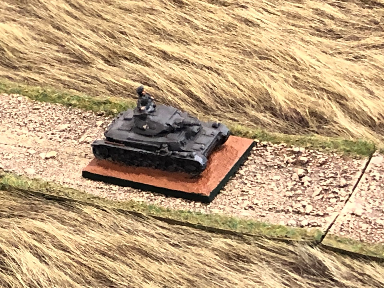

Here's what the muddy bases look like on the table at 'normal' tabletop distance.
A close up of the Panzer IV.
And the KV-1.
The KV-1 taking a shot at the Panzer IV.
So how does that look to you?  Can you stand it?  Should I?  Is there another alternative?

I've seen people use clear perspex bases in the past that then appear nearly invisible and just show through the mat underneath. Your tables are always so well set up so that could work quite well as you'll just see what is on the table base below - road, grass, snow, whatever!
I don't think there is an easy answer.
I tend to go with a mix of grass and bare earth on my bases in the hope they blend with various terrain.
The muddy bases look too uniform this makes them stand out against the background. Perhaps some dry brushing or washes to bring out the texture?
For snow you could add some loose flock to the vehicle bases.
The other option with vehicles is no bases! They are big enough to sit on the terrain as they are - but it does make storage harder.

Some of the members don't base 10mm tanks. I do as it allows the base to stop the tanks rubbing up against each other when stored.  I would base for summer with flock and ground then just use a green table even for winter, and factor in the weather effect into the scenario. ie less visiblity etc

Create a sabot by cutting out white felt to match the base size and then cut a hole that the AFV will push through.  However, if it is painted for summer it will look peculiar.  As the winter requirement is a white coating the ultimate solution is two sets of tanks. Our solution is for two of us to create distinct summer and winter armies and use each other's.  As a solo player that is not much use to you.

My current bases are a little bright; just realized I hadn't given them an ink wash yet...
