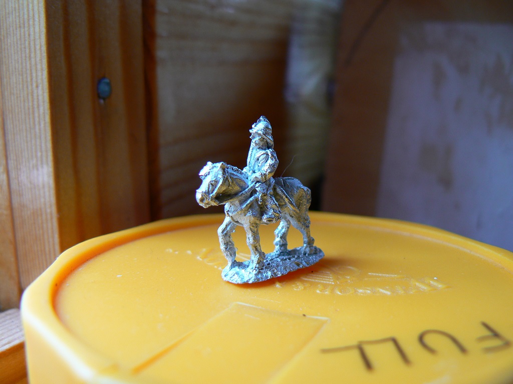

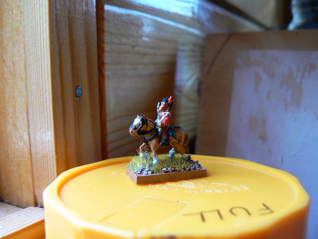

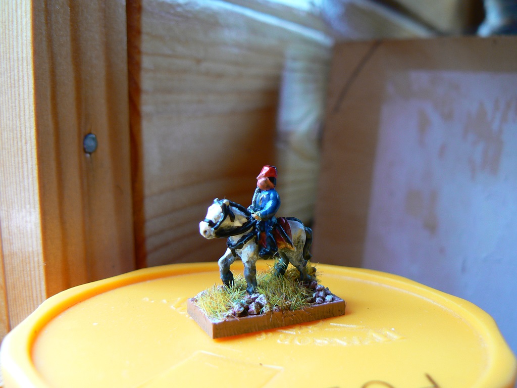

30 April 2020, 10:18:18 AM #10 Last Edit: 30 April 2020, 10:19:56 AM by jimduncanuk
The razor saw is far more dangerous than the superglue.
http://jim-duncan.blogspot.com/2020/04/head-swaps-10mm.html
