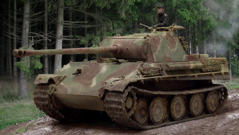

16 September 2017, 11:56:48 AM #12 Last Edit: 16 September 2017, 12:06:07 PM by fsn
Quote from: T13A on 13 September 2017, 08:47:37 AM
(presumably using some kind of set pattern)
Don't think there was a set pattern. IIRC, crews were issued with the red-brown and green paint to apply as local conditions dictated.
http://www.tanks-encyclopedia.com/ww2/nazi_germany/Panzer-V_Panther.php
