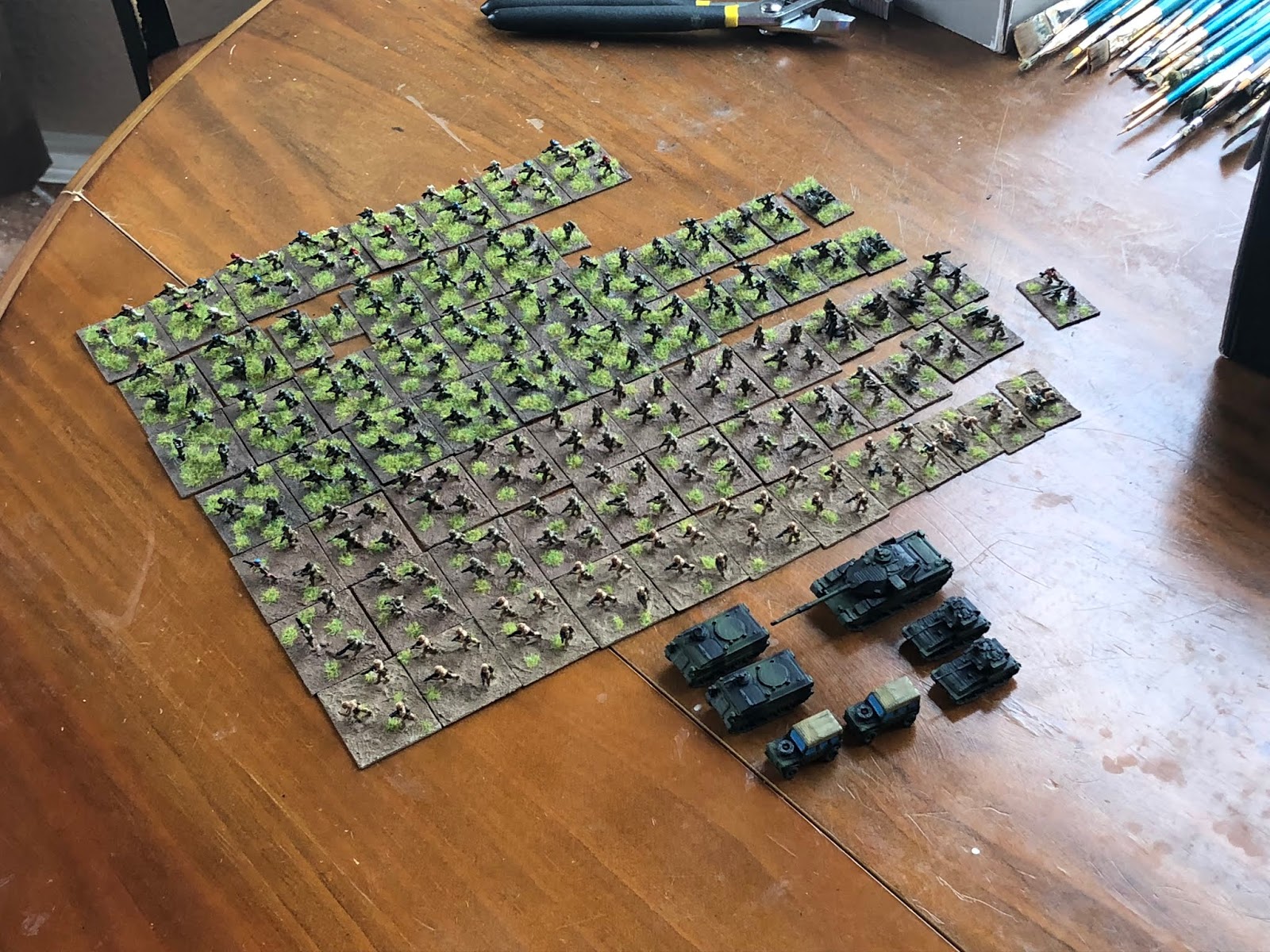

After a fair bit of experimentation I finally came up with a reasonable approximation of early war field grey. On reading about the non-fast nature of German dyes at the time I'm not too worried about getting slight differences from one unit to another.
I used the following to get this result:
I based the figures first and then terrained the base with Windsor and Newton Modelling Paste, adding some sand and coarse grit to a few areas while it was still wet. Next I primed the figures using Vallejo White Primer, followed by a coat of Stynylrez Black Primer. I then mixed at approximately 4:1 Americana Slate Grey and Vallejo Green Sky. This does look quite green when it goes on (and indeed can be left like this for jaegers). Next i did the trousers using just the Slate Grey. Then at this stage I gave a good coating of Citadel Nuln Oil Shade. This tones down the green to a much more green grey and also darkens and shades the trousers. At this stage I now do the faces by dabbing Vallejo Flat Flesh on the nose, chin, cheekbones, jawline and ears, followed by Citadel Reikland Flesh Shade. The next bit is the biggest bind with German troops - the red piping, Vallejo Red.I then turn to the back of the figure, ie backpack, beige brown, shelter roll, cavalry red, strapping and trench tool cover, saddle brown (also the ammo pouches and belting on the front of the figures), water bottle and trench tool handle, British uniform' bayonet scabbard and tin on pack, black, tip of scabbard, brass, jackboots, Mahogany sand, rifle, flat brown, muzzle, gunmetal, helmet cover, buff - all these colours are Vallejo. The last thing I do is the hands - again flat flesh and Reikland flesh shade. When finished and dry I give a coat of Vallejo Satin Varnish followed by brown magic wash and finally Windsor and Newton acrylic matt varnish.
Then I move back to the bases. First a coat of Crafter's Choice Yellow Ochre, then a liberal application of Citadel Seraphim Sepia shade. After this a dry brush of Vallejo Tan Yellow and a careful dry brush of the sand and grit with Vallejo Light Grey. I then painted some Vallejo Gloss Varnish into some of the hollows where the sepia had pooled to make wet areas. At this stage the the edge of the bases was done with Miniature Paints Brown Earth. The bases were then completed by adding static grass and some Great Escape Games tufts using PVA.
